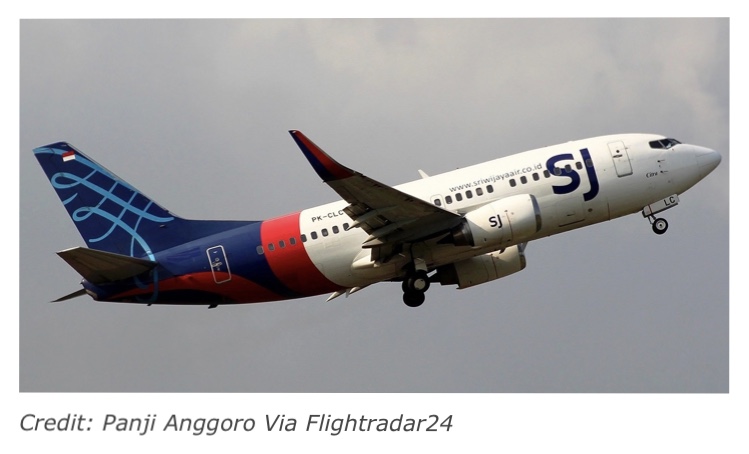

Crash: Sriwijaya B735 at Jakarta on Jan 9th 2021, lost height and impacted Java Sea
Da www.avherald.it
By Simon Hradecky, created Saturday, Jan 9th 2021 10:37Z, last updated Saturday, Jan 9th 2021 13:04Z
A Sriwijaya Boeing 737-500, registration PK-CLC performing flight SJ-182 from Jakarta to Pontianak (Indonesia) with 56 passengers and 6 crew, was climbing out of Jakarta about 11nm north of Jakarta's Sokarno International Airport over the Java Sea when radar and radio contact was lost with the aircraft at 14:40L (07:40Z). The aircraft has so far not turned up anywhere else. A search is underway. Debris and body parts were located in waters of about 15 meters depth near Lancang Island.
Sokarno Airport confirmed radar and radio contact with the aircraft was lost. Data review is underway, further communication to be expected from the Ministry of Transport.
Indonesia's Ministry of Transport confirmed contact with the aircraft was lost. A search and rescue operation is in progress under the coordination of Basarnas. First units of Basarnas arriving at the crash site between Laki Island and Lancang Island have located debris.
Basarnas reported they have deployed resources to the crash site and at the moment focus on locating the aircraft, hoping to be able to establish the position of the aircraft by monring of Jan 10th 2021. Several pieces of debris have been recovered already, however, it has not yet been established they are from the aircraft.
The airline stated they are in contact with aviation authorities and seeking more information. A statement will be issued once all necessary details have been established.
Residents of the islands nearby (Thousand Islands) were out on the sea in two boats when they heard two explosions, then found debris afloat at the sea. It was raining at that time. The residents returned one of the boats to their islands about 2 hours later and reported to police. The other boat is still at the scene holding position using an anchor. Thesse residents have so far recovered seats, cables, pockets and jeans.
The captain of a ship with 28 crew, that was located about 6nm from the impact site near Lancang Island, reported they were observing an object fall into the waters and set course towards the site. They found flight jackets, body parts and debris of an aircraft. The ship is currently holding position about half a mile off the observed crash site until rescue and recovery services (of Basarnas) arrive. The water is about 15 to 16 meters deep at the crash site.
According to ADS-B data the aircraft had departed Sokarno's runway 25R at 07:36Z, was climbing through 10,600 feet at 284 knots over ground at 07:39:50Z about 11nm north of Sokarno Airport and was at 07:40:11Z at 1400 feet at 307 knots over ground about 1.6nm northnortheast of that position (average sink rate 26,300 fpm).
https://flightaware.com/live/flight/SJY182/history/20210109/0640Z/WIII/WIOO
