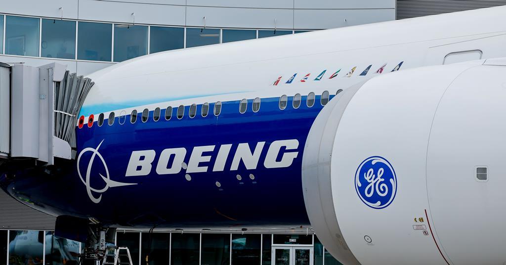

We have identified a potential durability issue during a recent inspection on the 777-9 engine, and we’re working with GE to better understand that issue and finalise root cause and corrective action,” Boeing chief executive Kelly Ortberg says during the company’s earnings call.
“Importantly, as we work through this issue, we continue our certification flight testing, and we don’t expect this to impact our delivery in 2027,” Ortberg adds.
“We haven’t fully turned the corner, but we’re making real progress getting back to the Boeing everyone expects of us,” Ortberg told investors on a Tuesday earnings call announcing the company’s 2025 financial results. “While I’m proud of what we accomplished in 2025, we also know expectations are rising, and we must continue to elevate that performance.”
Trovato un altro problema al 777-9, nello specifico ai motori GE9X. Non si aspettano che ciò provochi ulteriori ritardi, sarà vero?
