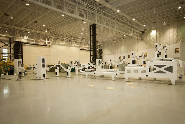

Bombardier Powers On the First CSeries Flight Test Vehicle and Completes Wing Static Testing Required for First Flight
Bombardier Aerospace announced today that it has successfully completed the first full powering on of the main electrical distribution system on the first CSeries flight test vehicle (FTV1). Additionally, Bombardier confirmed that the wing down-bending static test was successfully concluded on the Complete Airframe Static Test (CAST) article at the company’s Saint-Laurent, Québec facility in late March 2013. Together with the wing up-bending static test that was completed earlier in March 2013, the two most significant wing static tests required for first flight are now complete.
The company also confirmed that safety-of-flight tests are progressing well on “Aircraft 0” – the on-the-ground integrated systems test rig (ISTCR) for the CSeries aircraft.
