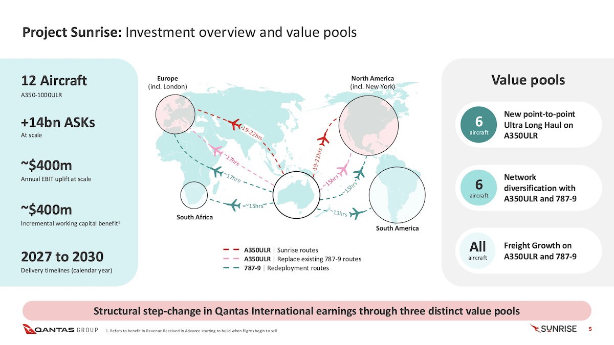

Sembra che solo 6 ULR (su 12) saranno effettivamente usati nelle rotte dove c'è necessità del maggior range, gli altri molto probabilmente saranno usati al posto di dove oggi usano i 787-9.
However, that strategy seems to have shifted. When you look at the investment case presentation that Qantas just put out about its A350-1000ULR, it tells a different story. Now Qantas plans to use only six aircraft for point-to-point ultra long haul flying. In other words, that just covers flights from Sydney to London and New York, with a couple of spares.
Then the remaining six A350-1000ULRs will be used for “network diversification.” The idea is that those planes will be used to replace Boeing 787-9s on existing routes, so they can be put on other routes. There has been some mention of the A350-1000ULRs potentially taking over the routes from Sydney to London and New York that operate via Perth (PER) and Auckland (AKL), respectively, as those are currently operated by the Dreamliners. While those are also ultra long haul routes, they don’t need the incremental range.
Based on the presentation, it would appear that the Dreamliners could then be redeployed to South Africa, South America, and a new destination in Europe.
Qantas doesn’t need the extra range on the other routes on which it plans to operate the A350-1000ULRs. These planes are ultimately a bit more expensive than the standard ones, though I guess the upside is that this increased maximum takeoff weight can also be used to increase cargo capacity, so there’s some upside there.
