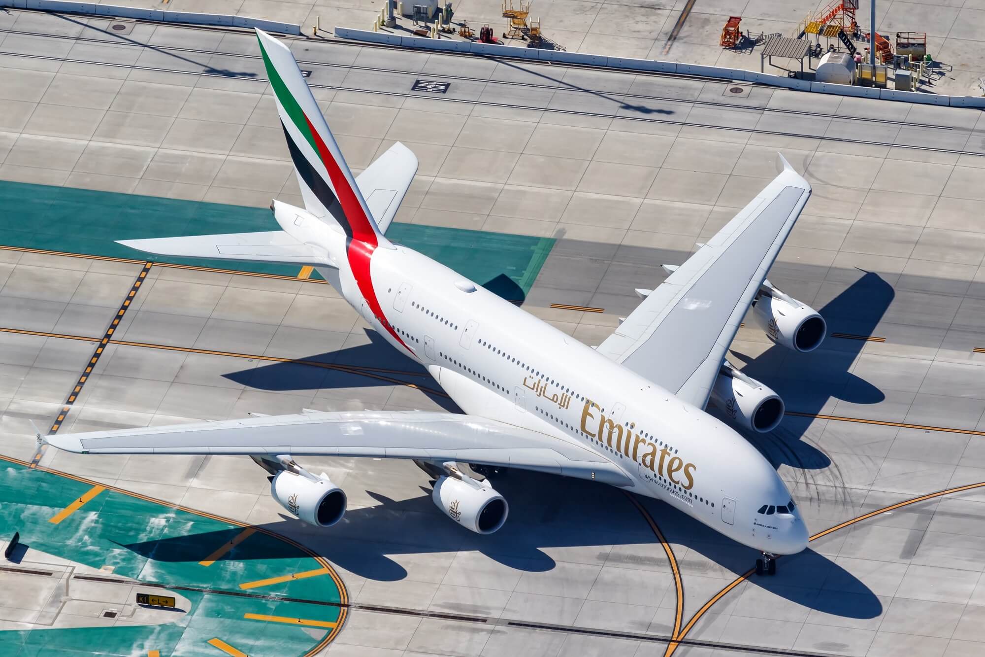

In un'intervista molto interessante, il presidente di EK Tim Clark ha evidenziato come la scomparsa dei quadrigetti (in particolare l'A380, ovviamente) influenzerà negativamente le tariffe aeree a causa della riduzione dell'offerta dei posti disponibili.
Clark ha inoltre "sollecitato" Airbus a pensare ad un'evoluzione dell'A380 sia in termini di materiali di costruzione, sia per quanto riguarda i motori, di ormai vecchia concezione rispetto ai nuovi ultra fan:
Spaeth: Has your quest to get any manufacturer, especially Airbus, to come up with an A380-size replacement largely fell on deaf ears?
Clark: My view is that the A380 could be rebuilt using the solutions we now have both in construction and design, aerodynamics, propulsion, application of composites to the extent that you could get 25% better [overall efficiency – ed. note] than today with the existing A380s.
Airbus agrees, but they say: “You put 50% of the development costs up”.
I said: “I am an airline, you are the manufacturer, you get on with it. Or you give me 50% so I can run my airline.”
The A380 uses propulsion that was designed in the 1990s for the 1990s and the early part of the last decade. So, propulsion has gone a long way with more coming. The Ultra Fan, for example. There is a possibility that you get a hugely efficient big player in engines at the top of the inventory requirements of airlines. It is not difficult to calculate what is happening by the mid-2030s, early 2040s if you do not do something, with all the quads gone – the A380s, A340-600s and Boeing 747s. That is why we keep the A380s as long as we can, as there is no other way we can go. But as demand skyrockets and there are no such big aircraft anymore, capacity will fall, fares will rise.

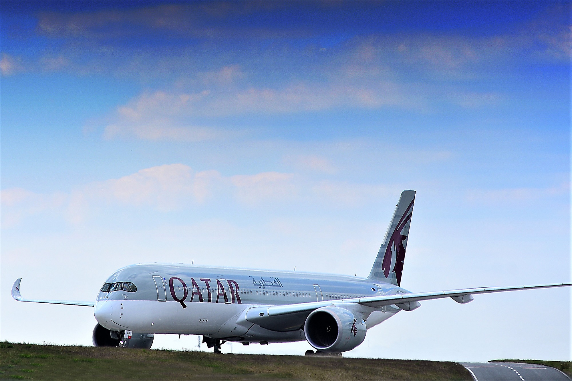

Inoltre Airbus ha già pronta la carta del 350-1100 (o come si chiamerà), in pratica un 350 allungato fino alla soglia degli 80m.
L'utilizzo dei RR Ultrafan dovrebbe garantire un risparmio di carburante intorno al 10% rispetto agli attuali Trent XWB, quindi l'aereo dovrebbe mantenere un peso massimo vicino se non uguale a quello dell'attuale 350-1000 e anche l'autonomia non dovrebbe essere troppo distante dalle 8.700 NM di quest'ultimo.
I pax in una configurazione mediamente premium, dovrebbero essere intorno ai 400. Non lontanissimi dai 520-550 che avrebbe un 380 in configurazione analoga. Solo che il 350-1100 dovrebbe avere un MTOW intorno a 320-330t, mentre il gigante è a quota 575t. E' evidente l'abisso di redditività che separa i due aerei.
Si stima l'entrata in servizio degli Ultrafan tra 10-12 anni, per cui presumibilmente il 350 da 80m (insieme al resto della famiglia rimotorizzata), potrebbe essere lanciato tra 6-8 anni.
E tra l'altro sarebbe un duro colpo per Boeing, in quanto il 779 (con capienza sostanzialmente uguale a quella del 350-1100),
probabilmente sarebbe meno efficiente del concorrente europeo.
Scenario molto pesante, visto che sarebbe riferito ad un aereo in consegna da non più di 3-5 anni.

Davvero così poco? Un 777W con capacità di posti analoga (400), viaggia sulle 350t
Il 351 attuale ha un MTOW di 319t e una capienza di 164.000 litri di carburante, che rapportati ad una densità media di 0.8, dovrebbero pesare circa 131t. Se l'Ultrafan dovesse permettere realmente un vantaggio del 10% rispetto al Trent XWB, su un 351 rimotorizzato si dovrebbe ottenere un'autonomia analoga all'attuale con un risparmio di circa 13.1t.
A questo punto bisognerebbe conoscere il peso della parte di fusoliera extra (al massimo 6.2m), ma secondo me se ipotizziamo un moderato calo dell'autonomia (per esempio limitandola a 8.000 NM, si dovrebbero risparmiare altre 10t), dovremmo aver compensato il peso extra dell'allungamento, almeno in larga misura. L'alternativa è mantenere intatta l'autonomia, aumentando leggermente il MTOW.
In ogni caso secondo me non andremmo oltre le 330t.
Tieni presente che il 779 ha un MTOW di 351.5t, che gli garantiscono un'autonomia di sole 7.285 NM, a fronte di una capacità massima di carburante di 197.356 litri.
E pure tenendo presente che Boeing è più conservativa di Airbus nei valori di autonomia dichiarata, secondo me tra il 350-1100 e il 779 ci sarebbe un'apprezzabile differenza di redditività.
