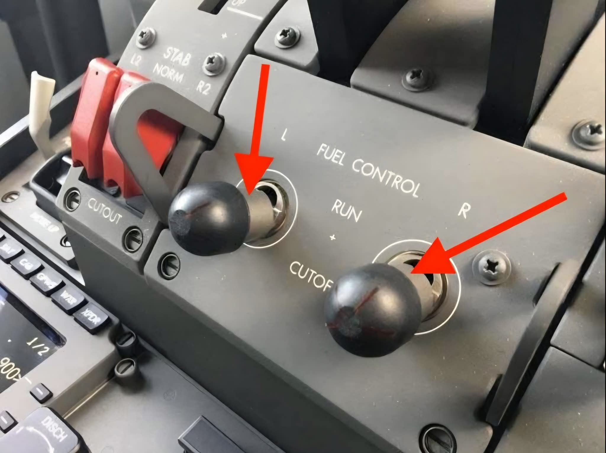

  1. Fuel Control Switches Vs Fuel Control Valves
Page 14 of the investigation report states that at 08:08:42 UTC, Engine 1 and Engine 2 Fuel Control Switches transitioned from RUN to CUTOFF position one after another, with a time gap of one second. The critical question here is whether the report refers to Fuel Control Switches or Fuel Control Valves. To the best of my understanding, the Enhanced Airborne Flight Recorder (EAFR) is designed to monitor the Fuel Control Valves, which physically regulate fuel flow to the engines and not the Fuel Control Switches located in the flight deck.
The switches merely send a signal to FADEC, which then commands the valves. If FADEC decides to cut off fuel flow while the switches remain in the RUN position, the EAFR would still record this as a valve transition, not a switch movement.
Therefore, the report’s reference to “Fuel Control Switches transitioning” appears to be a technical misstatement, unless corroborated by cockpit switch position data, which is typically not captured by EAFR.
This raises a deeper concern: Is this a genuine oversight or a deliberate framing that shifts the narrative toward pilot error?
Especially when cockpit voice recordings suggest confusion between the pilots with one asking, “Why did you cut off?” and the other replying, “I didn’t.
“The question remains, ‘Cut Off’ what? It could refer to any system involving the Engine or Thrust parameters.
For example, the first step in the memory item for a single Engine seizure or stall is to move the Auto Throttle Arm Switch of the affected Engine to ‘Cut Off’. However, even these Memory items are only executed after crossing 400 feet AGL, and always in a challenge-and-response manner, and not immediately after liftoff.
If the switches were never moved, and FADEC initiated the cutoff autonomously, then attributing the shutdown to pilot action is not just misleading, but it’s unjust. This inference amongst the general public stems from the selective leak of Flight Deck conversation, which, in the absence of full context, feels more quaint than conclusive.
