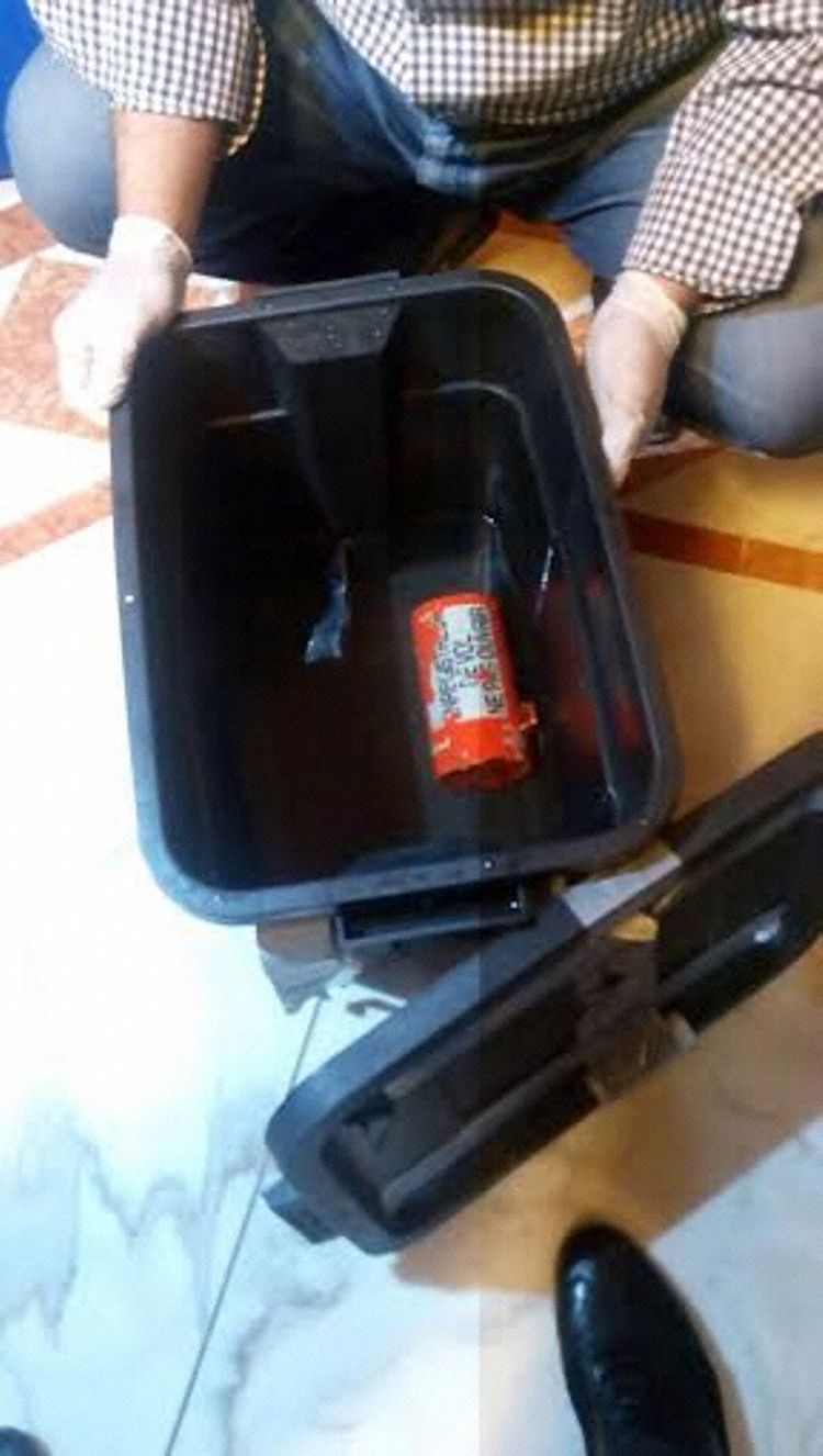

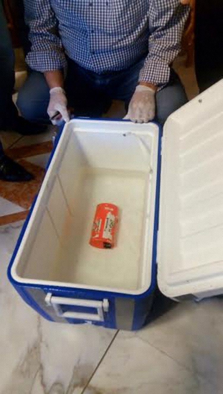

Later Jun 17th 2016 Egypt's CAA released photos of both memory modules (see below) reporting that the condition of the memory modules has not yet been determined. If the modules can be read out without repairs, download will commence right away, if there is minor damage only, the repair will be done locally, if there is extensive damage, the memory modules will be needed to sent abroad for repairs under supervision by the investigation committee. The process of reading the data out and analysing them will likely take several weeks.
