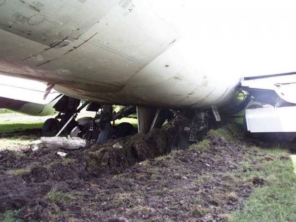

23 September 1999.
18 years ago - rain was now heavy enough that the runway lights were visible only intermittently after each windscreen wiper stroke.
Just before touchdown the captain, concerned about the long touchdown point (over a kilometre past the runway threshold) and unable to see the end of the runway, ordered the first officer to perform a "go-around" and the first officer advanced the throttles but did not engage the Takeoff/Go-around switch (TO/GA). At this point visibility improved markedly and the landing gear contacted the runway, although the aircraft continued to accelerate.
The captain then decided to cancel the go-around by retarding the thrust levers, even though he was not flying the plane. This caused confusion as he did not announce his actions to the first officer who was still flying the plane. When over-riding the first officer's actions, the captain inadvertently left one engine at TO/GA power and as a result cancelled the preselected auto-brake settings.
The landing continued, but manual braking did not commence until the aircraft was over 1,600 metres down the runway.
There were no significant passenger injuries during an orderly evacuation of the aircraft ordered some 20 minutes after the rough landing. Thirty-eight passengers reported minor injuries. The aircraft was substantially damaged, but repaired at a cost of $100 million.

Da tutto il report ufficiale, di quasi 200 pagine, non è dato sapere il destino ufficiale dell'equipaggio di volo: retrained or dismissed?
"...fai cosi'...", "...aspe', che nun sei bono...", "...faccio io che so mejo..."
"...maronna che casino emo fatto!"
Ho letto questo nelle prime righe dell'introduzione del post; poi ho pensato,vabbe', ma se han fatto 'sto casino mi sa che addestramento e procedure sono alquanto deficitarie...
E infatti: "Although the flight crew and cabin crew made a number of errors, many of these were linked to deficiencies in the Qantas operational procedures, training and management processes. "
Diciamo che e' andata bene, uscire dal fondo pista a 160kmh con un 747 non e' esattamente una passeggiata sull'erba!
