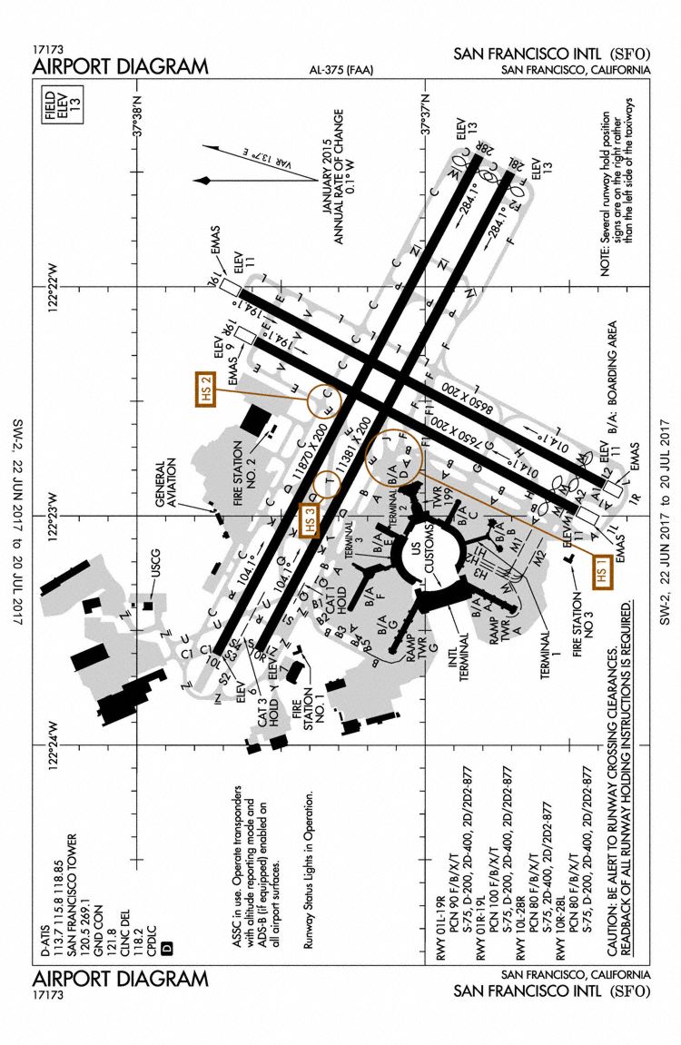

An Air Canada Airbus A320-200, registration C-FKCK performing flight AC-759 from Toronto,ON (Canada) to San Francisco,CA (USA) with 140 people on board, was on final approach to runway 28R in night conditions being cleared to land, when a short time after reading back the landing clearance the crew queried tower to confirm they were cleared to land advising they were seeing lights on the runway, tower advised the runway was clear and they were cleared to land indeed. Another voice chimed in calling they were lined up with the taxiway, tower immediately instructed AC-759 to go around as result commenting it looked like they were lined up for taxiway C. The aircraft went around from about 400 feet MSL. Other flight crew taxiing their aircraft on taxiway C commented the A320 was flying straight over them. The A320 positioned for another approach and landed safely about 15 minutes later.
The FAA is investigating the occurrence rated a serious incident. There were four aircraft on taxiway C, which runs parallel to runway 28R to the right of the runway.
On Jul 11th 2017 the Canadian TSB reported the crew of C-FKCK asked ATC to confirm landing clearance as they were seeing lights when the aircraft was 0.6nm before the runway threshold. The controller was coordinating with another facility when a flight crew of another airliner taxiing on taxiway C queried ATC where AC-759 was going and stated it appeared the aircraft was lined up with taxiway C. AC-759 had already overflown taxiway C by about 0.25nm when ATC instructed the aircraft to go around. 4 aircraft were on taxiway C at the time of the occurrence. It is estimated that AC-759 overflew the first two aircraft by 100 feet, the third by about 200 feet and the last by 300 feet. The closest lateral proximity between AC-759 and one of the aircraft on taxiway C was 29 feet. The NTSB is investigating the occurrence.

Non c'è una ricetta precisa per eliminare al 100% l'errore umano....humanum est! Ciò che si può fare durante il briefing è di evidenziare le possibili cause checonducono ad errore: due piste parallele molto vicine, di stesso aspetto e di stessa lunghezza, così come duevie di rullaggio parallele ad esse, sono uno scenario di cui discutere. Sicuramente in notturna una pista la evidenzi e riconosci grazie a molti fattori ad essa appartenenti: luci di avvicinamento di precisione (ove presenti e accese); luci di soglia pista (longitudinali, verdi, indicano anche una soglia spostata -displaced threshold); le luci di identificazione di soglia (due strobo bianche piazzate ai lati della tstata, RITL), luci di centro pista biance, poi bianche e rosse 900mt prima del fine pista, poi tutte rosse 300 metri prima della fine; il colore delle edge lights: bianco e non blu come le taxiway; touch down zone lights ove presenti; infine il Precision Approach Path Indicator, quelle 4 luci laterali (lato sinistro, destro o entrambi) che aiutano il pilota a mantenere un sentiero di tre gradi nella manovra a vista o nella transizione tra volo strumentale e manovra a vista finale.

Domamda da ignorantissimo .. ma le luci di bordo pista non dovrebbero avere colorazione diversa se si tratta di una Taxi piuttosto che una pista di decollo/atterraggio ?
e allora come mai un comandante in atterraggio visual non ha notato la psta con le luci corrette ? Nei dialoghi si sente come lui sia convinto di star scendendo sulla Runway e chiede alla torre come mai ci siano luci ( di aerei ) in pista ....
Si: pista luci bianche, twy luci blu.
Teoricamente anche quelle di centro pista....
Centro pista bianche (alternate bianche rosse per gli ultimi 900mt, solo rosse ultimi 300mt). Via di rullaggio: solo verde centrale.
Non te lo so dire....tutti sbagliano e la complacency del collega potrebbe aver contribuito all'errore. Di notte un aeroporto come SFO è un tappeto di luci, se poi ci metti i velivoli n movimento...
