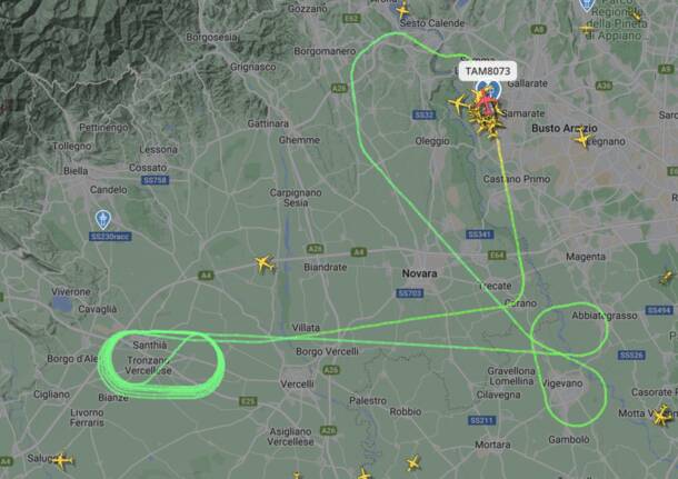

LATAM Airlines Brasil Boeing 777-32WER PT-MUG (CN / LN 38888 / 1052 - active), flight TAM8073 from Milan Malpensa (MXP) to Sao Paulo-Guarulhos-Governor André Franco Montoro (GRU), suffered a tail strike during rotation while taking off from MXP runway 35L. As a result, runway 35L was closed for inspection. Flight TAM8073 performed a fuel dump and landed safely at 12:50 UTC on runway 35R.

Ho appena visto il video del tail strike Latam, una bella grattata!!!
E' stato veramente lungo, sarebbe bello vedere una foto della coda, secondo me han fatto un bel danno!
