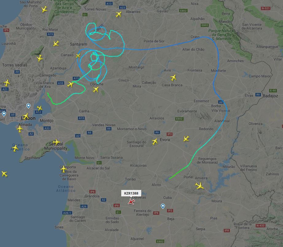

Poche decine di minuti fa, un E190 di Air Astana, durante un volo di prova dopo manutenzione a LIS, ha avuto seri problemi di controllo. I piloti hanno inizialmente chiesto di ammarare nell'oceano Atlantico e, una volta riguadagnato il controllo del velivolo, hanno ripetutamente chiesto una pista con buona visibilità; uno dei due F-16 portoghesi che li ha intercettati si è offerto di guidarli (letteralmente) fino a Beja, nel sud del paese:
kz by davideS, on Flickr
L'aereo è riuscito ad atterrare con successo a Beja. Tutte le comunicazione con l'ATC erano live su LiveATC al momento dell'incidente.

Già davvero da brividi e pensare che ieri l'ho seguito in diretta su FR24, quei giri e quelle variazioni di altitudine erano strane ma ho pensato a un errore nel tracciato

Swapped aileron controls (so when a right input, the a/c would turn left and vice-versa). Only elevators, rudder and thrust available to control the aircraft. As far as I've heard from someone who talked to the crew when things were settled down on ground, no issues when the autopilot was connected, but as soon as they would disconnect it, the controls were lost everytime. One of the four tonneaux ended at around 4000ft on a 90º nose down attitude. Adding to these awkward conditions, the wheather here in Lisbon area have been awfull the whole day with pouring rain, heavy clouds and low ceiling, so they had no visual geographic references, plus they were unfamiliar with the terrain and there's where the F-16s came in, to guide the E190 to a safer place. After "learning" to control the plane, all calmed down a little bit, but they needed an airport with better weather/visual conditions and Beja was the best, which is also in a sparsely populated (thus the lowest FR24 coverage, adding to the fact that the a/c doesn't have ADS-B and only shows up in MLAT) area so in case of a crash, the possibility of having victims on the ground was much lower.
On the first landing attempt, the aircraft wasn't well aligned to the runway so a go around was performed. On the second attempt they were a bit too high and went around again, before finally successfully landing on the third attempt. Of the 6 pob, two were taken to a local hospital with minor injuries and a third person, someone from the administration of Air Astana was reporting some heart issued ans was also taken to the hospital, which all three left by the beginning of the evening.
