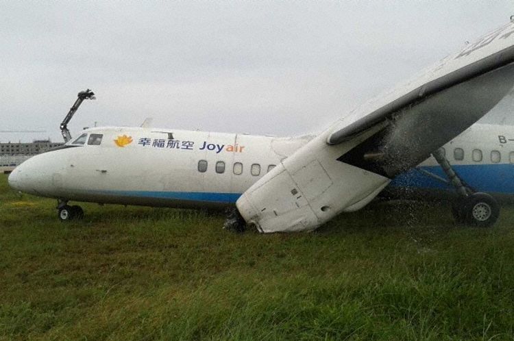

Joy Air MA60 skids off runway at Fuzhou airport
A Xi’an-based Joy Air MA60 skidded off the runway while landing at Fuzhou Changle International Airport May 10, resulting in a wings and fuselage junction fracture phenomena. According to Flight Safety Foundation’s Aviation Safety Network, the wings of the aircraft were twisted, causing the engines to strike the ground.
Joy Air said there were 45 passengers and seven crew members onboard; five passengers suffered minor injuries.
The aircraft, which is powered by Pratt & Whitney PW100-127J engines, was operating as flight JR1529 on the Yiwu-Fuzhou route when the runway excursion occurred.
Fuzhou airport was closed until 17:30, while more than 20 flights were delayed or canceled.
The cause of the incident is still under investigation.

Accident: Joy MA60 at Fuzhou on May 10th 2015, runway excursion on landing​
By Simon Hradecky, created Sunday, May 10th 2015 20:12Z, last updated Sunday, May 10th 2015 20:38Z
A Joy Air Xian MA-60, registration B-3467 performing flight JR-1529 from Yiwu to Fuzhou (China) with 45 passengers and 7 crew, landed on Fuzhou's runway 03 at about 11:57L (03:57Z) but veered right off the runway and came to a stop right off the runway edge about 500 meters past the runway threshold and about 50 meters off the runway centerline with all gear on soft ground. The engines made ground contact causing the wings to be nearly torn off and substantial damage to the fuselage and structure. 7 occupants received injuries in the accident.

The aircraft off the runway:
