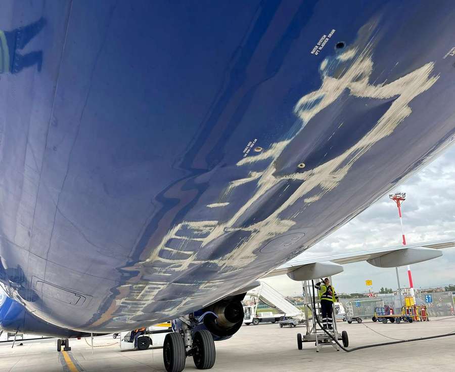

riporto quanto letto e sentito tra vari siti, sembra sia sceso come un sasso.
Boeing 737​
-82R​
40871​
3212​
YR-BMM​
Blue Air​
bady damaged incl heavy struatual damagee on hard landing 13may22 OTP-NAP, poss w/o​
ex TC-AAS​
sicuramente verra dismesso..
riporto quanto si trova nell'articolo postato sopra:
"There is another picture online, purporting to show this aircraft, having a buckled fuselage. However, this is NOT a picture from the Blue Air hard landing. It is from a 2019 accident, involving a 757 in the United States "
Grazie per la segnalazione, la fonte sembrava attendibile ma, in effetti, non vi sono troppe altre fotografie in giro, almeno sui siti maggiori.
Reactions: 777Aeromexico
La prospettiva del “lampione” rispetto all’altra foto sembra corretta… Sembrerebbe lui.

"On May 18th 2022 The Aviation Herald received information, that the aircraft touched down at 120 KIAS (Vref 137 KIAS), 1200 fpm sinkrate and about 8.9 degrees nose up attitude experiencing +3.83G vertical acceleration also resulting in a tail strike, just at touch down a GPWS wind shear warning activated (but is assumed to have been erroneous due to the severe hard touch down. While the flight crew was aware of the hard landing, the tail strike was only discovered at the gate. Preliminary investigation results suggest, that the aircraft - after the autopilot was disconnected at 1500 feet AGL - descended below the glide path starting below 200 feet AGL, a GPWS glideslope warning occurred, the vertical path was corrected however without adding thrust causing a low energy state of the aircraft".
