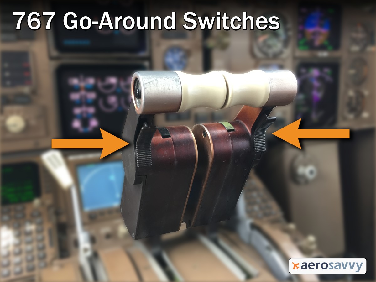

During the approach, at about 6,000 FT (being flown by the first officer), the Captain reached around the throttle quadrant to extend the flaps to the next position after being called to do so by the first officer (pilot flying)… very normal.
In many aircraft including the 767, that’s a very odd/difficult repositioning of your hand (from the left seat, all the way around to the right side of the center console), and requires intimate familiarity and slow deliberate motion to do successfully.
Well in any case, it was not done so this time. The captain accidently hit the “go around” switch while bringing his hand around for the flaps, which brought both engines up to full power. In the landing configuration, as this aircraft was transitioning into, that obviously causes a vast increase in lift… and the first officer (pilot flying) used everything he had to force the nose back down.
Still not sure why that occurred, as the crew should have just “gone around” and tried it again when properly configured… but they did not. And that started in motion a chain of events that lead to tragedy.

Credo sia utile poter visualizzare i pulsanti TOGA del 767 per capire come possa essere successo.
