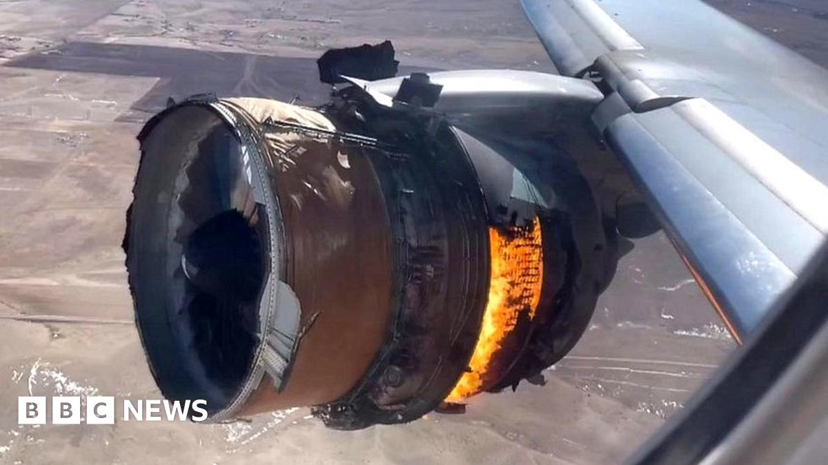

Il fuoco non può essere dovuto dal fatto che la turbina non gira più perfettamente sul proprio asse ma, vibrando, si crea un effetto "sfregamento" su ciò che resta dell'alloggiamento?
My two cents:
Se l’albero non girasse più sul proprio asse ci sarebbe uno sfregamento all’interno del motore.
Il fuoco che si vede nel video è esterno al “case” ("involucro" della camera di combustione/turbina). Se ho capito bene, quella zona dovrebbe essere dove prima si trovava la capotta del reversore. Quello che si intravede non sono le palette, ma i deflettori (penso).
Mi sembra più probabile una fuoriuscita d’olio che in contatto con le parti calde del motore entra in combustione.

Si pure secondo me quelle fiammelle sono i fluidi idraulici spruzzati attorno alla camera di combustione. Infatti si spengono da sole poco dopo.

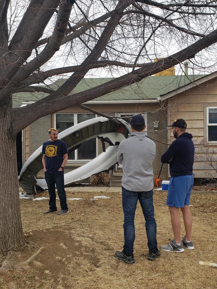

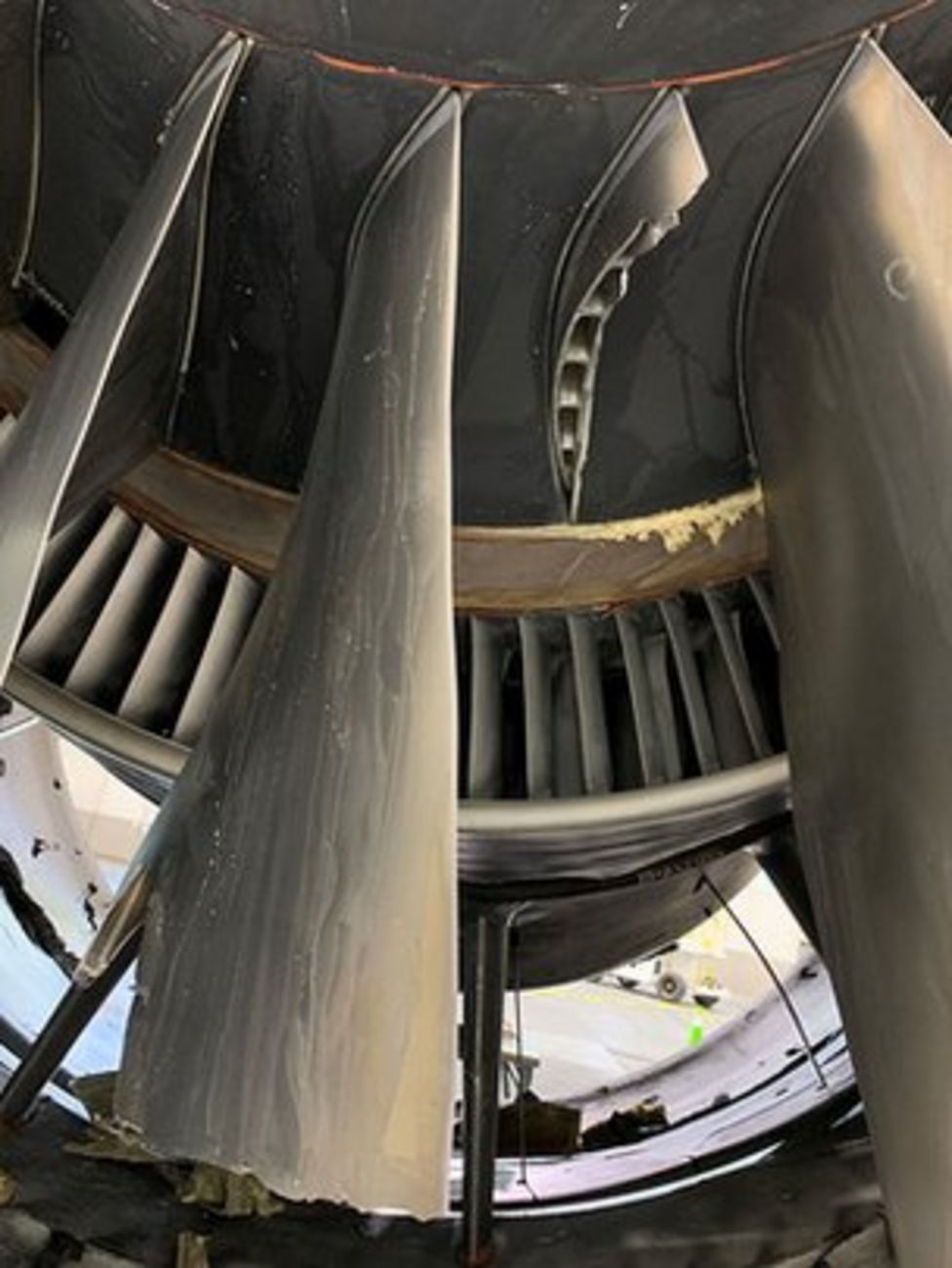

"On Feb 22nd 2021 the NTSB reported in a virtual media briefing that the right hand engine suffered the failure of one fan blade at about 12,500 feet MSL, the fractured blade caused an overload to the neighboured blade which fractured about mid span. Following the failure the crew pulled the fire handle and discharged both fire bottles. Fuel was turned off. The NTSB is looking into what caused the fire to continue. There was additional damage to a composite fairing, the damage was not structural. One of the blades was found in the soccer field on the ground. Following landing the crew assessed no emergency evacuation was necessary. Metal fatigue played a role and is being looked at. The engine's maintenance history is being reviewed. Additional debris was found Monday morning (Feb 22nd 2021) in Arvada about 20nm westsouthwest of Denver Airport. First inspections of the engine do not suggest that anything pierced the containment ring and engine case. At this point the NTSB does not consider the engine failure as uncontained, the containment ring did contain the fractured fan blades, the failure thus was contained."

Comunque, basta guardare i vari "spaccati" del PW4000 (di cui io avevo un poster nel mio studio :geek:) per notare che la zona da dove fuoriuscivano le fiammelle corrisponde a quel punto dove le parti rotanti hanno il diametro più stretto (leggasi high pressure compressor stage) che quindi non frizionano con la paratia in oggetto. Sono piuttosto convinto chela spiegazione di @Jambock sia quella più acceeditabile in questo contesto: trafilature di liquido idraulico o olio motorea contatto con parti calde dell' HPC/HPT o combustion chamber.
Segni di "metal fatigue" secondo la BBC:
Una foto interessante:
