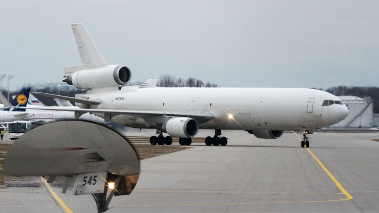

A planespotter took a photograph of the aircraft in Munich which showed blood stains at the right hand side of the fuselage.
Ground staff at Munich Airport noticed the blood stains as well and reported the blood stain. The blood stains were identified as result of a bird strike however and no further action was taken.

N545JN taxiing in Munich on Feb 13th 2016, blood stains enlarged (Photo: Markus Schwab):
