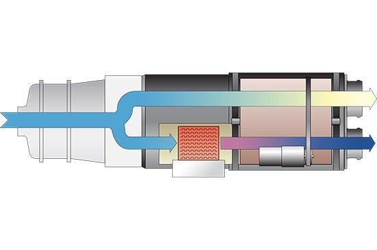

Swedish-based CTT Systems’ Anti-Condensation System sucks up the moist air from the crown area or cargo area and divides it into two airstreams. The first feeds past a slow-moving silica-gel rotary drum to absorb humidity. A specially designed “piccolo” duct, (with regularly spaced holes; like the instrument) releases the now-dry air between the ceiling panels and the external skin of the aircraft.
Electric heaters warm the second airstream before it, too, passes by the silica-impregnated rotor. This heated air sucks up the absorbed moisture from the gel and jettisons it overboard via the aircraft’s air-recirculation system or through the outflow valve.
