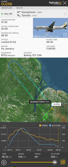

The aircraft had been around 10min into its flight OJ256 to Toronto when it turned around to head back to the departure airport.
Fly Jamaica says the twinjet had experienced a “technical problem” but that it subsequently suffered a landing accident. The aircraft appears to have conducted its approach to runway 06.

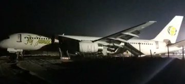

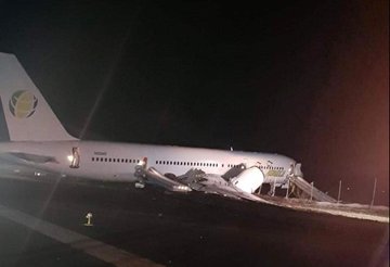

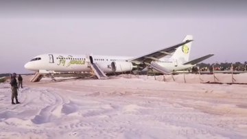

Accompanying images from the airport operator, on its social media feed, indicate that the 757 has suffered substantial damage to its starboard wing and engine, as well as its landing-gear.

A Fly Jamaica Airways Boeing 757-200, registration N524AT performing flight OJ-256 from Georgetown (Guyana) to Toronto,ON (Canada) with 120 passengers and 8 crew, was climbing out of Georgetown when the crew stopped the climb at FL200 due to a hydraulic failure and decided to return to Georgetown. The aircraft landed on Georgetown's runway 06 at 02:53L (06:53Z) but veered right off the runway and came to a stop to the right of the runway just short of the runway end. The aircraft was evacuated via slides. There were six minor injuries, the aircraft sustained substantial damage with the right main gear collapsed, the right engine sparated from the wing and right wing damage. The injured were taken to a hospital.
