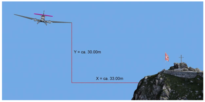

[...] Although the summit [of the Gross Mythen] was largely in the clouds/fog, [the plane] flew past the summit extremely close to the side. [...] I filmed the scene. I think that the images document the high level of risk-taking, which at least two pilots of Ju-Air took here, to impress the passengers. [...]
